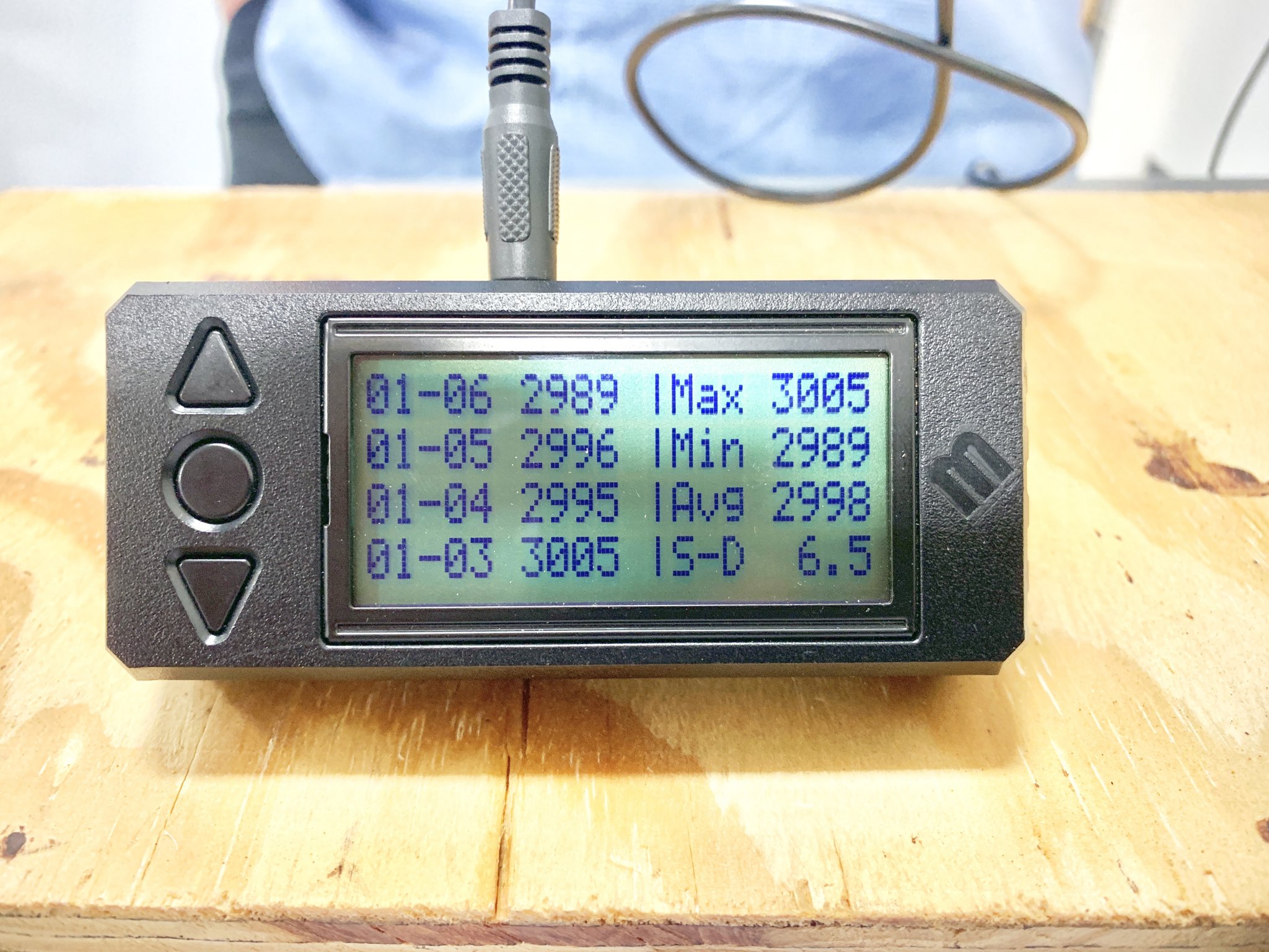

I've been playing around with a 22-250AI I built last year, and I am finally narrowing loads down to what I intended the build to be for. It's a 21" 1-7 #3 X-Caliber 5R barrel I chambered on a R700 in a Manners EH2. Shot in the .2s with the first H4350/75 A-Max fire forming load I came up with. There's not a ton of info on 90gr bullets, so I bought Quickload to mess around with. After realizing that the H20 capacity was WAY off in the program, I got it adjusted to match my formed Lapua brass, and I got some solid info to start from. I started with H4831SC.
90gr Berger
Formed Lapua brass
WLR
41.0 gr H4831SC
2.660" OAL (touching lands in my chamber)
2998fps
Not really what I was looking for as far as speed, but it too shot in the .2s. I have a bunch of RL17, so I tried that...
