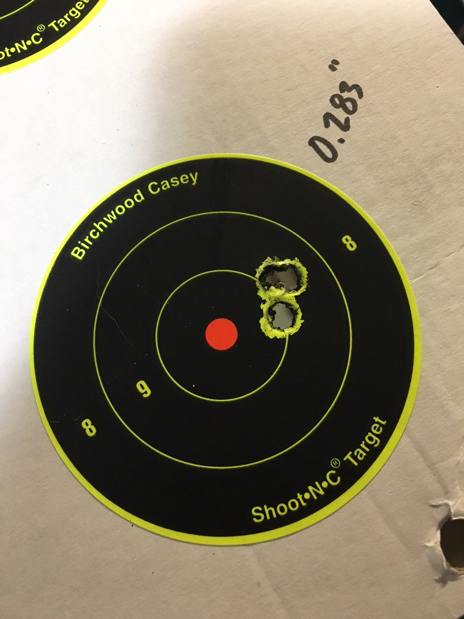

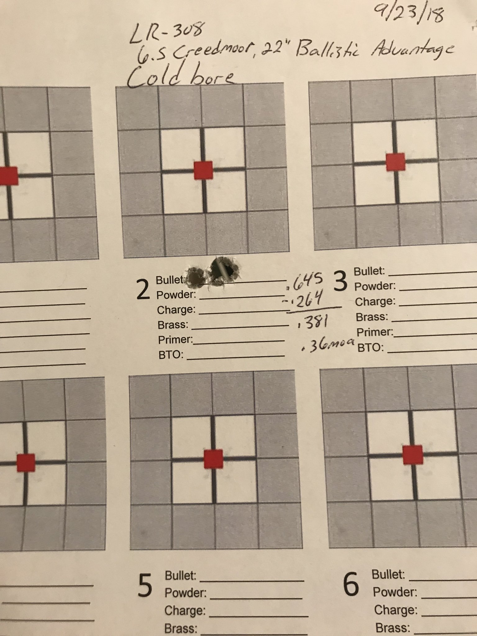

I'm running 130 hybrids, H4350 and Lapua Brass in my 6.5 Creedmoor. The Nosler reloading manual calls 43.0 grains as the max load for 130gr bullets. I did some OCW tests from 41.5 to 43.0 grains and nothing exhibited pressure signs. The 43.0gr loads aren't compressed either. They shoot great in my Surgeon with a 24" Hardy Barrel. Pretty much every charge weight from 41.5 to 43.0 shot well, I just went with 43.0.
I think my COAL is right about 2.831", so just a hair over factory spec. I'm only running them about 0.005-0.010" off the lands. Can't recall exactly offhand.
