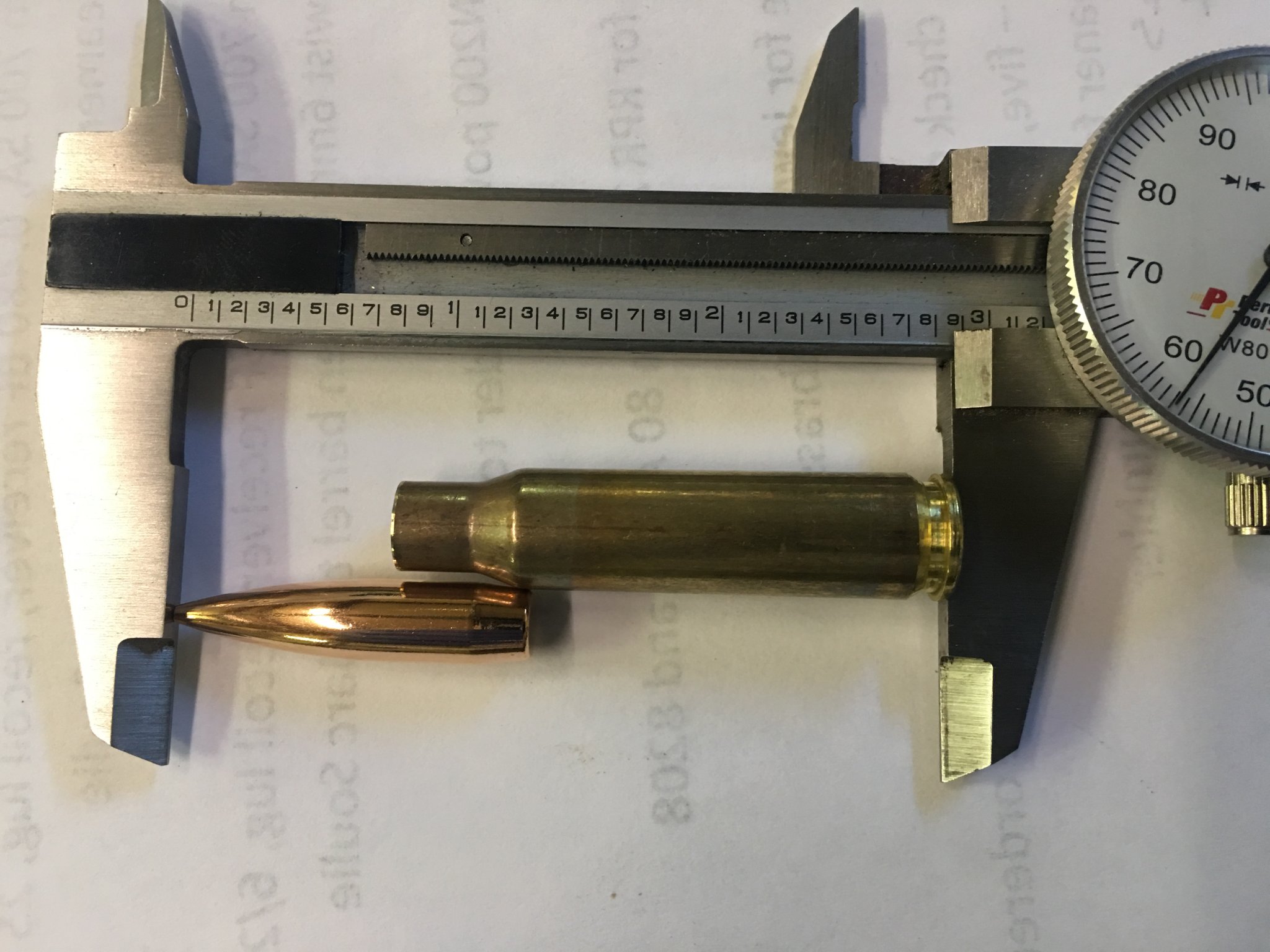

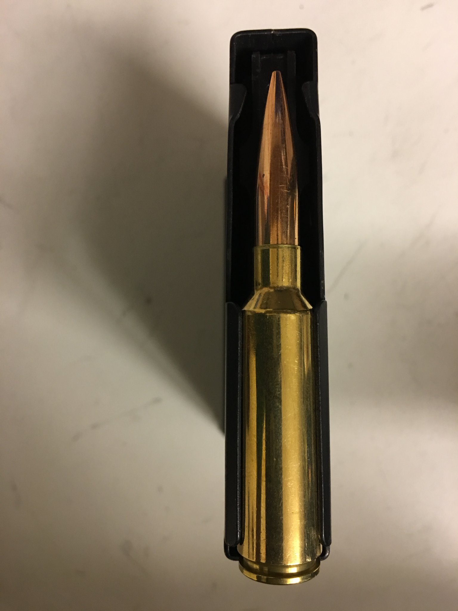

185 Juggernaut you really don’t want that much freebore. If running 200.20X, maybe want 0.170” of freebore but that’s way too much for Juggernaut even for single loading.
185 Juggernaut w/BT / bearing @ N / S,
0.060” ish FB is all you need / want for 185 Juggernaut. Can’t comment on 200.20x as I haven’t made up a dummy rd for that one to get measurements on.

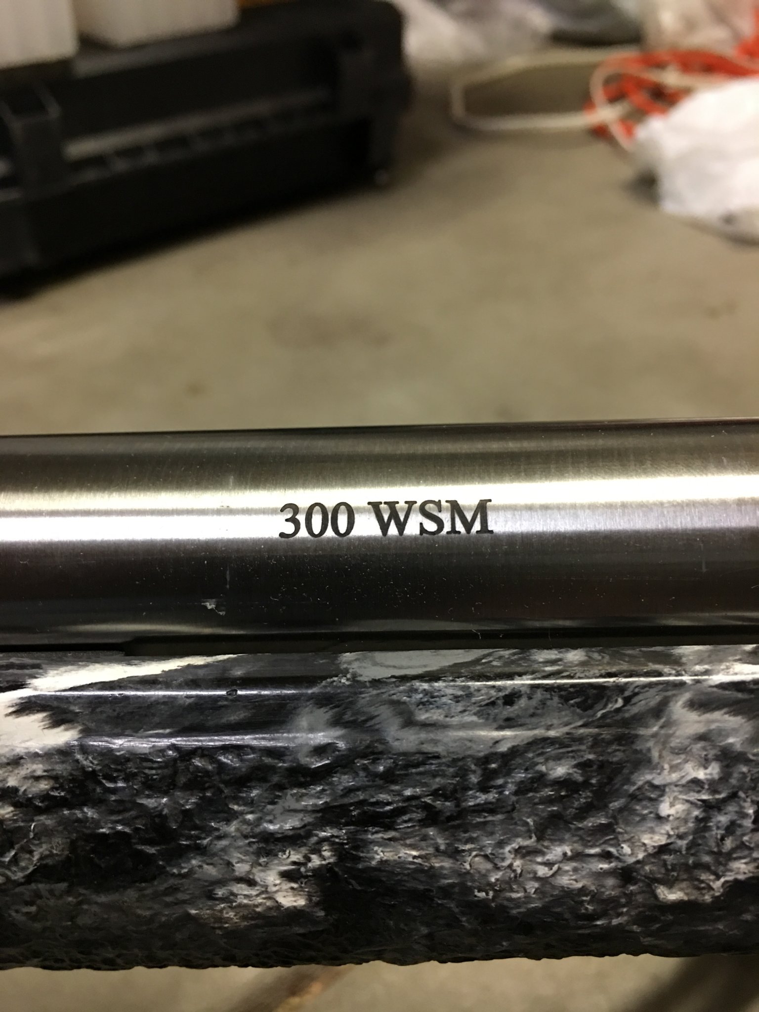

I'll be experimenting with the 20x soon... Out of a 300 WSM! trying these at a mile. I'll report my results soon.
