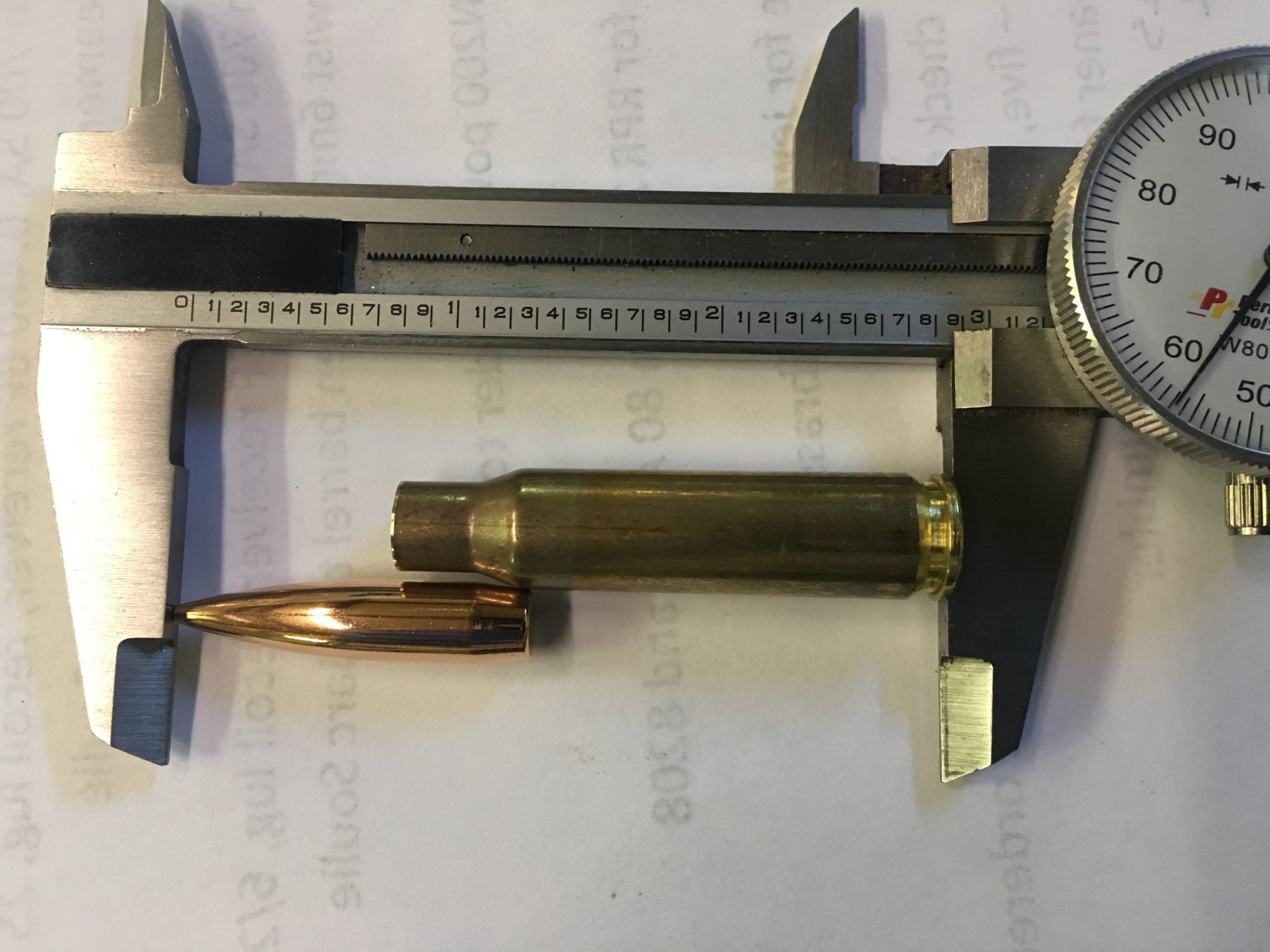

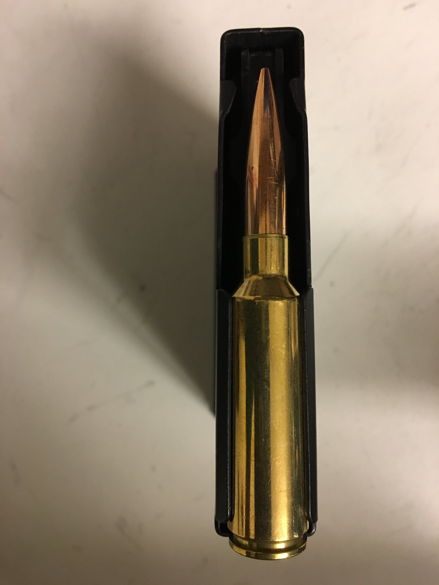

300 WSM set up for 215 / 230 hybrid acts like a 6BR on ‘roids, need 3.100” ISH OAL and 338 LM AICS mags if you want to run from magazine.28878A94-B458-49C7-9006-0D52959A6365.jpeg
